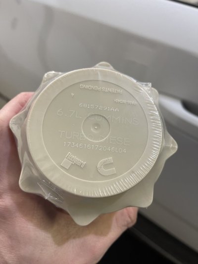

I would avoid the FS43255 as the micron rating isn’t as good as the updated one. I think they learned that unit wasn’t good enough. The FS53000 is the way to go. Can get them for around $60. Just make sure they are from legit seller and don’t look like this!
