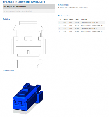

quick question, i just recently bought the 77KICK41 and 77KICK42 off ebay. got them today actually.
will i need the 1/4 inch spacers?
for the dash speakers if i decide to do the resistor, i'm seeing the Metra 72-6514 Speaker Wire Adapters, but since the speakers are a mopar kit but that wouldn't plug into the speaker, i would like to be able to make it plug and play.
i found this, but i would need the connector also (the blue piece in the pic). but not sure where to get it, i found the full repair kit on ebay but it does not include the plug

They should drop right in, no spacers.you may not need any resistors
As stated the speakers will fit in place, no spacers needed.
You'll probably want the resistors inline with the dash speakers as they will be quite harsh, may still be with the resistors.
I switched to the 77KICK28a set up for the fronts, the dash speakers have crossover capacitors already installed on them. Makes the truly a Plug-N-Play set up for the front.
