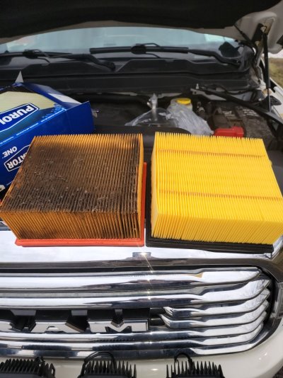

At a little over 44k miles, my truck threw a CEL on Saturday. Had a friend of mine with a code scanner check it and it had 3 codes that showed.
He said the codes were for a knock sensor. I'm like great, how much are those to get fixed. Not expensive but apparently it resides under the intake manifold.....ugh.
I asked him what usually causes the knock to happen and he said the sensor can go bad, computer issues, and it could be running in a lean condition.
I said let's go check the truck real quick...I popped the air filter box open....this is what I found.1000002046.jpg
Shame on me for not thinking about changing the air filter after the first year or so. The air filter on the left was the original. The new one is a Purolator. Will have everything checked probably by tomorrow.

The knock sensors are located on the side of the block on the 5.7's and 6.4's,not under the intake.All you have under the intake are the mds and vvt solenoids,and an egr cooler on the truck 6.4's.

Well.....that's good to know now. Going to have to get under and start checking everything out now. Hopefully it isn't wiring *****'d or the sensor corroded out. Ill get it to the shop to have a look.
