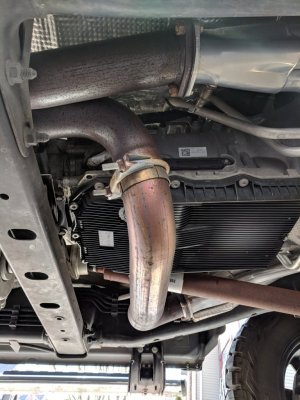

I like them, fitment is tight but the improvement was worth it. I had a nightmare install due to various issues. Pretty sure it crosses under the trans pan, but I'll snap a pic to confirm when I get home from work.

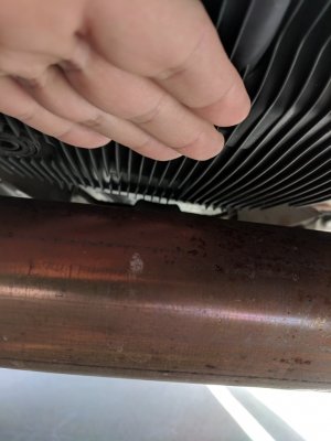

Here's the JBA pics. Looks like there's about 2 inches clearance between the pan and mid. Plenty of room for a wrap.IMG_20180420_150622.jpg IMG_20180420_150659.jpg
