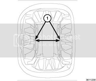

There is actually a measurement that can be done on the side gears. The measurement is taken from the distance between the two side gears. If it's above spec, the carrier is supposed to be replaced.

No, not backlash. Differential backlash is measured between the ring gear and pinion gear, which has no effect on the LSD portion. This spec is to measure the distance between the two differential side gears, 1.66" is the max. If it's above its likely there is excessive wear on the clutches,side gears,case etc.

Oh ok, ya no that's not the measurement they want done. As far as I know Chrysler doesn't even list a spec for side/pinion gear backlash. I pulled the picture out of the service procedure showing where the measurement is taken.

That seems much easier than guessing how to read diff gear backlash. Although I would guess a normal caliper would be a pain to get in there.
