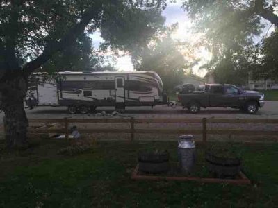

Pulled similar with both a ram 1500 and ram 2500 diesel. If you have the money go with the 2500 no question. It is doable with the half ton legally, but you will be adding airbag, sway control weight distribution and spend a lot on gas. You will white knuckle a few windy days and wish you had the 3/4 ton. But it is doable.
Sent from my iPhone using TapatalkImageUploadedByTapatalk1444439334.057685.jpg
Half ton
ImageUploadedByTapatalk1444439354.378922.jpg 3/4 ton
