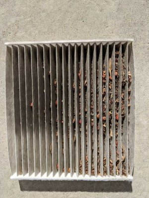

Once again I was placing the insurance card in my glove box and I saw leaf fragments in there. My 3/36 warranty is up on Monday. I called to make an appointment to have the dealer look into the mystery of the leaves in the glove box. When they said they needed the vehicle for the whole day as they might need to pull apart the dash I told them to forget it.
I pulled my cabin air filter and boy, was it filthy. Yes, I park underneath a tree, a crabapple tree. I cleaned the filter best I could and reinstalled it. I will monitor it and see if I get any leaves in there again. It might take until next fall though. Meanwhile, I will replace the cabin air filter with a new one.

Don't think it's mice or chipmunks. However, it is interesting that there are oak tree leaves in the mix and the nearest oak tree is across the street in the neighbors back yard, so I'm not ruling it out. I pulled the glove box out and there were some leaves scattered in the area behind it. My cabin air filter was filthy but undamaged by rodent gnawing. I don't understand how the leaves can be intact.
I opened the hood and there were leaves crammed into the vent grills and all along the base of the windshield. I cleared those out.
