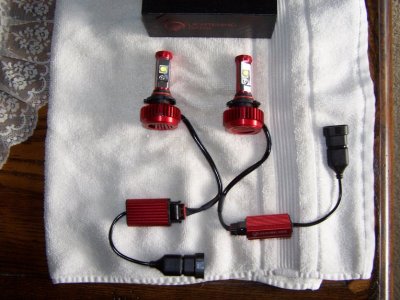

I put in some OEM black headlights and some Lightning Bright LED bulbs from Amazon, lows, highs and fogs. HUGE HUGE difference.

That is very true. But the bulbs above your post are LED and *uaually spread the light the same as the halogen/incandescent counterparts.

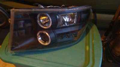

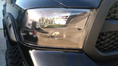

I just pulled these Spec D's off my tuck. I really liked them. However, if you have a lifted truck, they are not compatible and I do not recommend them as they do not have an option to adjust the beam other than putting some spacers in the top mounting bolt to tilt them downward. Unfortunately, that is not sufficient.
I replaced them with the same quads A05GSHO pictured in a previous post on your thread, except I got them with the clear sidemarker rather than the amber. $120 off ebay. Now, I need to upgrade the bulbs and would like to go HID, but seems some say you can and others say you can't. LED will suffice just to get anything brighter in there. Will follow this to see what info comes about.
