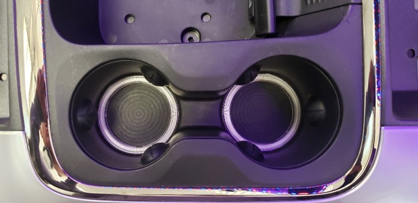

I got one of the newer center consoles with the phone holder for my 13. I got it on eBay cheap because someone slashed it up with a razor or something? I wrapped the top in a silver vinyl to match after smoothing out a couple of the cuts with sandpaper and today I added LED angel eye cupholder lights. Not sure if they will be too bright at night but they look good for now, plus I usually have drinks in the cupholder anyway. I got 75mm angel eyes with plastic lens and they fit perfectly. I tapped into the the interior dimming light circuit behind the light switch for power so they are dimmable, but they are still pretty bright. I didn't have to glue them in or anything, as they fit pretty snug. There's a possibility I may have to tint the plastic lenses or something if they end up being too bright at night dfc98df2975acc41f890ea640ad37ed4.jpgcde8bd43c87a87270c56a0841571cf1e.jpg

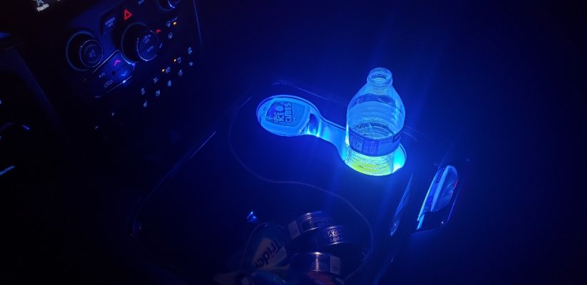

Pretty bright at night, but stuff in the cupholder makes them not as bad. I still may try to dim them down. Maybe paint the plastic housing or something. 39982f3888ecebae5779d06134104e79.jpg

Yeah I was thinking of I was going to do it I'd paint 90% of it and leave the bottom kinda open so it shined down more than up. Looks sick though!
