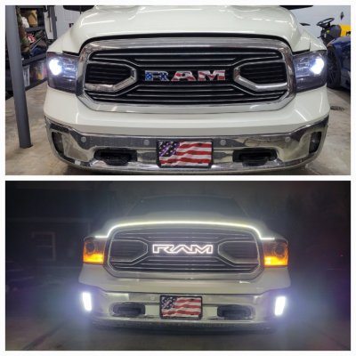

@RamDiverI ended up going with the Fahrens you suggested, plus i added LED RAM letters. I think it turned out pretty well.
The Fahren link was from @CanuckRam1313, I just agreed with his advice. :cool:
Are you happy with the lights?
You will have to post a link for the Ram emblem illumination kit, others will be interested. :cool:

@RamDiver Only on my 2nd day with the lights, but so far so good!
Here is the link:
I had to cut the entire center section out of the grille, but I like the way it turned out.
Awesome and thanks for all the pictures.
Please keep us posted on your lights too.
Glad to hear everything went well with no surprises. :cool:
