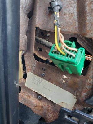

I have a 2012 Ram 1500, no factory footwell lighting harness from what I can see. I have a couple small, stick on LED lights that I want to wire up under the dash on both sides. I need to tap into the dome light wire as I want the lights to come in when I open the door/ unlock the door. I'm trying to find info for the location and color for the wire I will need. I have done a lot of searching and it seems the colors vary depending on the year of the truck. I did read one post where the color is said to be white with yellow stripe in the drivers access panel on 2011-2012 trucks , but it was never confirmed. Just looking to see if anyone had this information
Thanks
Ramnm08
Jul 14, 2018
54
23
Jacksonville, FL
Solid yellow and black/orange chaser come from the dome light down to a connector just behind the cover on driver side. The power wire for the solid yellow is yellow/white chaser. Hope this helps.
