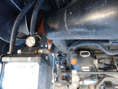

what would be the best way to mount a couple of led light cubes under the back of a 1500? Would rather not drill into the bumper.

Use the existing bolts already there and just slide a bracket under one of them

Nothing wrong with that bracket. I just preferred to have them tucked up slightly underneath and a little more hidden88cef610f379bc04cec5e7c06e57e61f.jpg

This is on 3500. Don't know if bumper mount is the same or not.
Added couple of L brackets under the bolts there.
I like that. Those are the lights i have. How are they mounted?
Just used an “L” bracket from Home Depot and widened the hole so I could use an existing bolt. I’ll try and take a pic for u on my way to work
