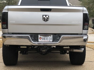

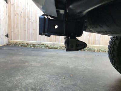

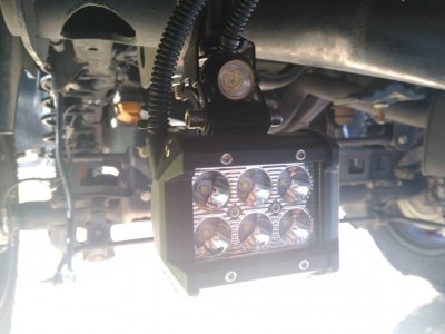

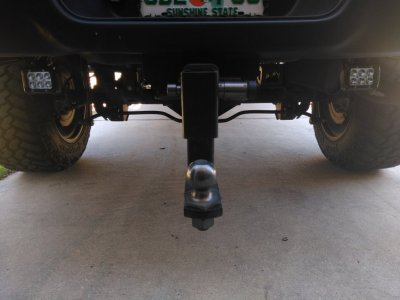

Something like this will give you the flexibility to angle them however you want. These are mounted to my tow hitch with exhaust clamps.IMG_20180115_132830.jpg

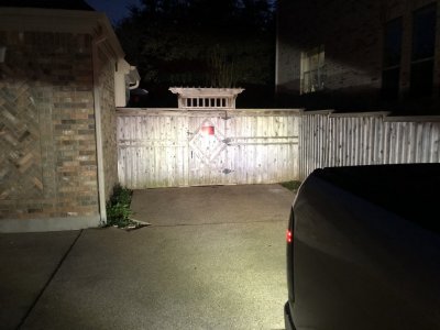

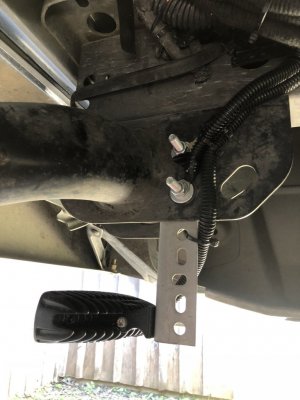

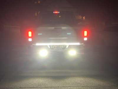

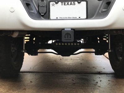

Here is what I did. Lights were about $20, I tapped into my trailer harness reverse light, and cut some angle iron to make brackets. Bright as day now when I put it into reverse. When I swap my bumpers out, I will be putting diffused floods (Rigid) cubes in my bumper. These will remain backup lights.
Holy crap those are bright!! See ! I love that simple mounting system ya got. Lovin it !

That’s brilliant! How did you secure them ? Aside from using the clamps
You cant really see the exhaust clamp in this pic, but get a clamp that fits the size of your hitch, I believe I used 3 inch clamps, could have been 5", I don't remember. Once those are on, there is enough thread coming off the exhaust clamp to bolt on the lights. You can move them left/right/up/down as you desire.
I wired mine into my driver side reverse light, so they only work when in reverse. You will see a small single light attached to the top of the cube, those are hooked to my bed light switch and are for light needed when loading up in the dark and truck is off and in park.

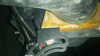

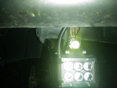

Meant to include a shot that better depicts the exhaust clamp hookup. Here you go!
And paint those exhaust clamps if you go that route, which I did not do yet. They get rust dust on them real quick
