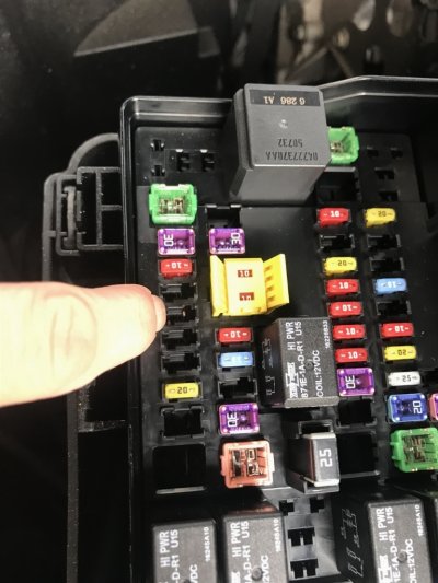

Alrighty. So mictuning emailed me back and I must say I’m impressed with how fast they were!
Anyways, they said instead of getting power from positive battery post the said to use a fuse location. Problem is I don’t know which ones are spare fuses. I looked inside the fuse box and I looked at the diagram. In the manual I noticed two that said “spare” off the top of my head I can’t remember what the fuse number was. So will these “spare” fuse locations have power to them? Or is it simple a holding place to keep spare fuses ?
On trucks I’m guessing spare powered fuses would make sense seeing as how trucks are meant for work. So adding lights, ploughs, CB radios etc....
If someone with knowledge about these trucks could chime in that’d be great!
Addicted2fishing
Addicted2fishing
Jul 2, 2017
3,077
2,821
Durham region
HEMI 5.7

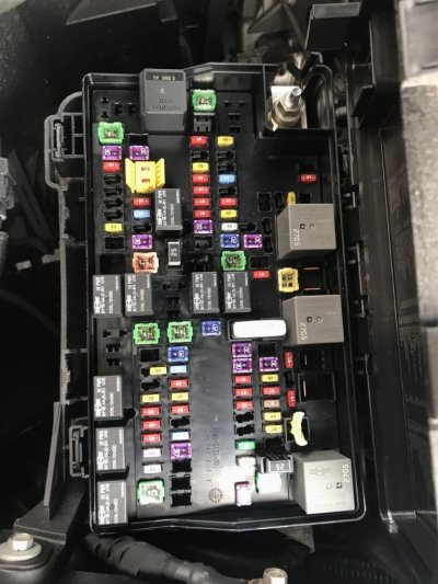

Ok so for those still following I went into the cold and tested the fuse slot F101. It’s a blank live fuse and only has power when key is in acc or on [emoji106]. Great success (Borat voice).
Blanks F102 and F103 are not live and are empty so nothing can be plugged in. As you look there is only that one with connection points. So that settles one light. Now I gotta find one for light in the front.

For the front rough country bar I think it’s a 90 watt and I’ll use the cigar lighter F93 fuse location which is not always on and it’s a 20amp yellow

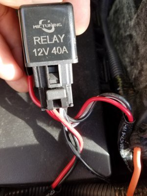

Thats a mictuning harness?
I have 2 and red is battery hot, black is ground, white is switchleg that operates their relay. From the mictuning realy is leads to lights.
In pic the black n red to left is to lights, black red n white to right to switch inside cab. Red connects to switch (hot), black is ground and white is what engages relay when u push the button

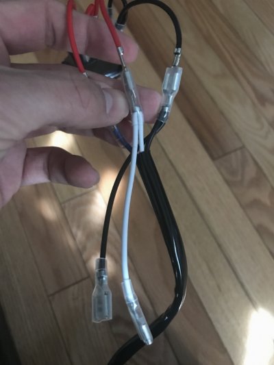

I mocked it up on my boat battery and I noticed when I jiggled the switch in my hand the light would flicker. Bad switch ? Or hooked it up wrong ? The harness they supplied has a quick connect and white, blue and black. They also have two female ends the come off the black and white. Not sure if I’m suppose to use those or if they are redundant as I have the harness hooked up.
I used their diagram and also used the supplied wires that have splices in them to join the connections. I can’t stand electrical. I should just drop it off at a shop and say call me when it’s done. I’ll hook up the actual lights and they can do the rest.
This is what I did......

Ok this is what mictuning said ha ha. I’m even more confused......
“Thank you for your pics.
Actually the you got 2 5 pin switch wire ,could you pls remove the wire which came with your switch,and use our wiring harness to connect your switch directly.
The"U"tpye Black to the battery ground of 7,8 position on the switch.
The"U"type white to the positive of 2,6 position on the switch.
The blue to the 3 position of the switch.
Any further concerns,pls feel free to tell us.”

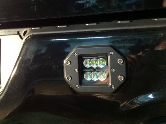

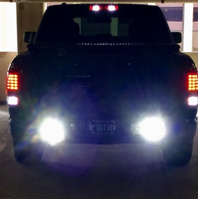

Here is my set up. Flush mount pods, and I tapped into the reverse lights on the trailer wiring harness.

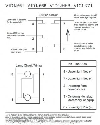

looks like your using the Contura V lower independent switch, maybe this will help.
