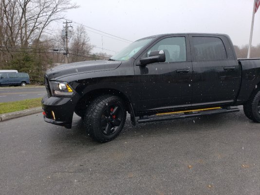

I've got the Recon "Big Rig Ice Lights" version on mine. I've had them on for several years now with no issues. They have Amber Running & Turn and White Step lights.

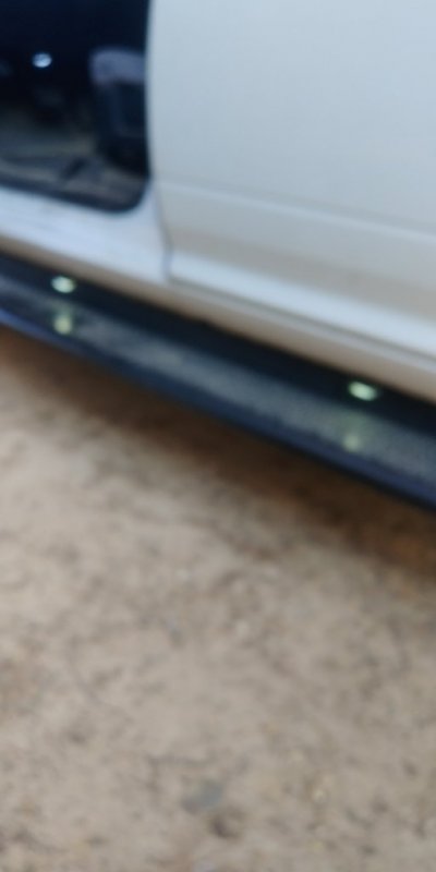

Here's a link to another thread that has pics of the connector...I tapped into these same 'courtesy light' wires to light up these lights on my running boards and also rear seat interior lights (see page 2 of the thread)...The running board lights are white LED License Plate lights and light up when door is opened, fob unlock/lock and 'fade to off' like the other courtesy lights...
Thread 'Rear Footwell Lighting' https://www.ramforum.com/threads/rear-footwell-lighting.157376/View attachment 483594
This is great thanks. Exact connector I thought you meant. So I have this but it doesn’t do anything since I don’t have lights lol
