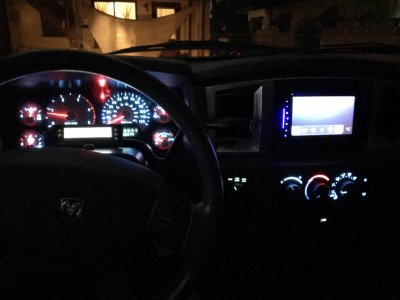

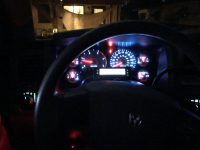

On the centre console, where the button/knob is for the 4x4 and seat warmers... does that light up?
Very rare I drive at night, since middle-of-nowhere so nowhere to drive to. :)
Anyways, got my stereo installed, and at night was playing with settings and noticed that the knob for the 4x4 lights up, nothing else does in that section, except the LED that comes on when the 4x4 switched or seats turned on. Otherwise no backlight at all. Can't recall if was one before or not, in case I loosened a wired when doing the stereo install.
Also, the 3 buttons (AC/Defrost/Recirculate) light up an LED when pressed, but when off, totally dark at night, can't see them at all.
That normal?

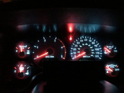

Can't help you on the 4x4 question, mine is a 4x2. As for the other, you have 3 buttons? Mine only has AC & Defrost. I do believe the buttons themselves light up as well as the amber light above it when the button is pressed. I'll confirm it more after I switch the lights from Pure White LEDs to Green LEDs. The Pure White doesn't emit that much light, as seen below. So I'm gonna give green a try.
mwclarksr
Sep 11, 2013
116
33
Mooresville, Indiana
2002
4.7L - 287cid
Update: So, it's actually my Climate Control lighting system that is not working properly, not the LEDs. Only 1 of them light up, so I need to get a replacement Climate Control. As for the AC & Defrost buttons, yes they do light up also. So if yours are not lit up, then it's the bulb closest to the buttons that is burnt out.
