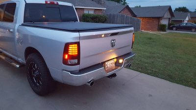

If you have an autoenginuity you can run LED tails w/o needing resistors. Just have to enable the LED Tails option and build harness' w/o resistors. Its what im running on mine. ht1CXO6.jpg
