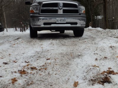

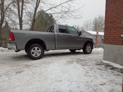

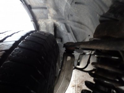

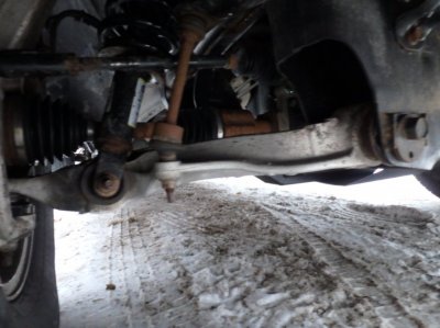

here are some crappy pics. anyone have any ideas what the binding could be. if i coast well turning it doesn't bind, only binds when i hit accelerator.

Doesnt look like 4" of lift but looks good everywhere else! Is everything tight and torqued to spec? Binding is usually a CV

it doesnt look like 4" because for some reason it only lifted it just over 2". everything is tight. im taking it back to the place that installed the lift to double check everything
