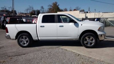

Probably won't fit here's mine with just a level ImageUploadedByTapatalk1416713415.603874.jpg
A long long time ago haha
EDIT: the top pic is leveled with 285 70 17
(33's)

Heres mine with 1.5in from Performance Accesories, the website says you can fit 34"s im going to run 33"s

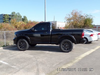

I wanted 35's on my 14 2wd with no worries about rubbing. I used the maxtrac spindles and 3" rear coil kit. They also have a setup with rear spacers but I wanted some take for when I tow. Cost me $850.

I will measure the ground to center bottom of the flare 43f and 43 1/2r give or take 1/16" it was getting dark. Without the flare it would measure a little taller. Truck looks like it has more rake then it actually does.

Thanks for the info; truck looks awesome man. I'm still trying to figure out my setup. I took another measurement tonight - top of wheel to bottom of wheel well - I'm at 5-5.5"...kinda worried about having a 10" gap if I install the 4.5" spindles.
10" gap where? The flares only sit a 1/8 to 1/4" lower than the bottom of the stock wheel. What are you running now? What do you want to run? Tire wise and height? Tell me your setup. I have seen the 7" Maxtrac on a truck with 35x12.5's different brand wheel/tire than mine. Looked good. I want to up it to the 7" of i keep mine and swap on 37x12.5's.

You could just use the spindle with that size tire and add the spacer in later if you want to go higher. To me the spindle with a 34 to 35 fits perfect. Plus it drives the same as when it was stock. It is a lot better than my 09 that I had with a 2" spacer and longer shocks on.
