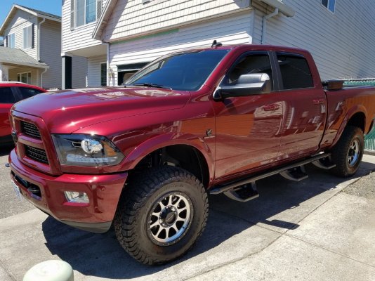

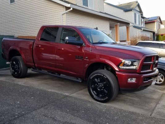

I have a Tuff Country 2" spacer level (on top of the coils) on my 2017 Cummins and it works well. I got the one with the shock relocation bracket. It lets you run the stock shocks and helps maintain suspension geometry.
I've run this same product on 2 other 2500s (a 3rd Gen and a 4th Gen) with no issues. I'd say I've run them about 160K miles on those two trucks.
Between all 3 trucks I'd estimate I have run the Tuff Country producs over 180K miles.
Stock profile with 20" wheels:
With Level & 35s on 18" wheels:

You mind if I ask the specs on those 18 inch wheels? I'm getting prepd to pull the trigger on wheels and I like the stance of those. I don't want to go too wide outside the fenders.
18 x 9, +18mm offset

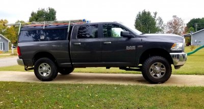

Here is mine. I have 305 70 18 tires which Mickey thompson says is close to a 35 12.50. Just looking at pics my tires look smaller than most guys with a regular 35.

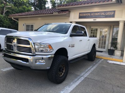

2.3" Bilstein coil level with a 1" rear spacer to get some rake back. 285/75-18 Nitto ridge grapplers (35's)
Which rear spacer did you go with. I've been contemplating doing that on mine.
