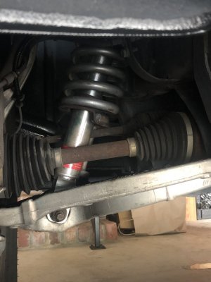

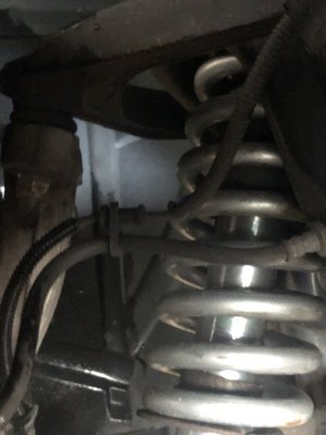

Had my setup installed today. Eibach Pro Lift Front Kit and a 1.5 inch rear spacer. Took 10days from order to receive the parts directly from Eibach.
Before: front 37 rear 39
After: from 39.25-39.5 rear 40.5
Pictures below. I am beyond happy. Drives much differently, doesn’t react to bumps as hard and overall seems to ride much better from what I can tell. UCA and CV angles don’t Look to bad to me but I am not an expert on those.

Looks Great @bbaxley01 your angles look good too. Nice choice
