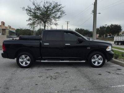

Thanks to Brandon and Guys over at MaxTrac. After reading post after post looking at picture after picture marking this part off that part off. I can finally stop the madness .
Before and after pics !!

Very stout, which level did you choose?

I went with the MaxTrac kit the 2" coil spacers. I wasn't going to put them on I ordered the kit with out measuring stock I sat 36.5/39 I thought the 2" kit would still give me rake and not level so I didn't want to spend the coin to get it installed. I had to get some info from MaxTrac and Brandon cause I was looking to purchase a 2.5" spacer so the numbers would match up. Wow was I wrong if I put a 2.5 in I would have the so called Cali Lean and I didn't want that. The mechanic was impressed with the spacers and said they matched up with the springs perfectly and said it was a great kit. As for the ride is a tad stiffer in the front but I expected that. But I had to do this to be able to run 33's I luv the way it came out !!

I also added a 3" front ans 2" in rear now im at 42 " all the way around . Looking to fit 37's soon..
