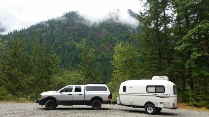

I have that exact lift. Bilsteins at 2.8, and tufftruck springs. I have a topper and custom cabinets inside full of search and rescue gear. That sits at a slight rake, with towing about 300lb tongue weight it sits level.978dfb9471c0fbe125d55ef912c91546.jpg

Looks awesome, what size tires and how much lift did the springs give you. Also what weight percent did you get. When I was looking them up I saw 20% stronger or 50?

Tires are LT 265 70R17s load range E. I have the 50% stronger springs, not the variable rate. It still rides great, but I have a constant load in the bed over 500lbs.
