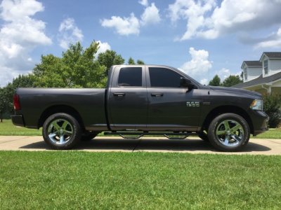

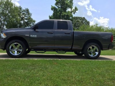

Is it a 4x4 or 2WD? Cause if it isn't 4x4 then you won't be able to use the Bils. I have a 2WD. I got the Mevotech's from carid.com (around $90 shipped) and topgunz 2.5 inch front spacer (find them on ebay and call to order the 2.5 inch) for $75. Gunna post up pics tomorrow once I clean her up! Good luck! Post pics after!
Edit: Photos of the level installed
