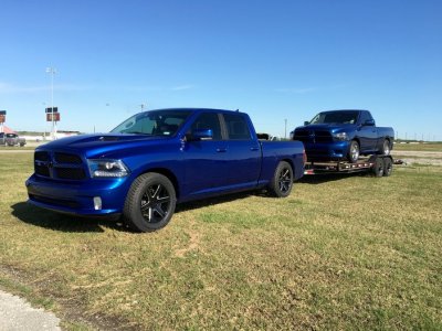

A Lot. Here is my 2015 with a 2/3 lowering kit pulling 7800lbs with stock height tires...
Not in the bed, but that's a sick picture lol
Its the same principle though. Doesnt matter if the weight is in the bed or on a trailer, a simple set of helper bags in the rear coils actually makes a lowered truck more functional for towing/hauling than a bigger lifted truck. The lower bed height makes it much easier to load items into the bed, makes it easier to see while pulling/backing up a trailer, and doesnt catch as much drag while also makes it easier to pull while getting a little better mileage.
Many people are under the impression that a lowered truck is not as functional as a lifted truck, but that is far from accurate. The only real functional benefit to a lifted truck is the extra ground clearance offroad. Just about everything else is easier/better with a lowered stance.

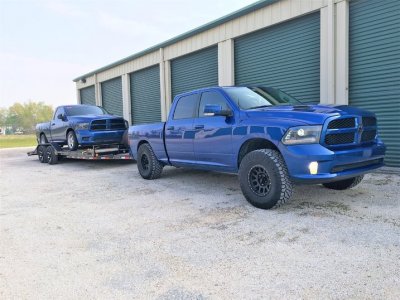

Just for fun, here is that exact same truck and trailer being pulled by the exact same truck, but with a front leveling kit with 35's and no helper bags. This truck really struggled to pull that same 7800lb trailer after I lifted the front and pulled the helper bags out of the rear.
