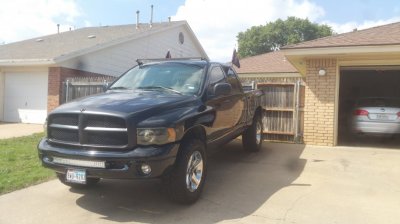

Pics of truck, everything shaved, 35s

I don't off road at all its a 2wd just for looks so I should be fine ?, I'd be good with my 3 and an extra 2" for 100 bucks , I wouldn't be stacking spacers I got the rough country suspension lift which includes new shocks and coil springs to get the 3" no spacer involved ? Just wondering if the stock a arms Wil fit ?, what is ls5 running ?
