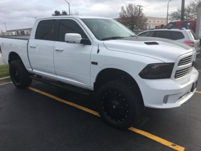

Finally got my 4" BDS installed. I now know what BDS stands for.... BADASS!! Turned out much better than I thought it would. And my 35's look killer! Rides awesome!

What are the chances I could get you to measure from the concrete to the top of the truck ( the truck, not the antenna ), Id be forever grateful :) :baby:
EDIT : Hell, if you could do contrete to top of the bed, that would be cool too!

I'm at 80" and the bed is at 59". That's with a Zone 4" with 35s and 3" coils in the back with the Bilsteins set at 1.4.
Okay, thanks. I was thinking I was a bit low, but I guess not. I'm at 84 to the roof, and 62.5 in the back. I guess I'm just imaging things :( :favorites13:

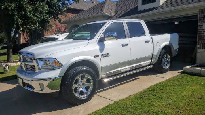

I can go measure tomorrow, but I can tell you that I barely squeak under my 84" garage door opening, but I can get it into the garage, and that is with the shark fin antenna.
Thanks, 84 inches is 7 feet even, with the shark fin, you should be at about 86 inches, which shouldn't fit into any normal home garage. you sure you're 7 foot tall with a 4 inch lift? That seems mighty high.
EDIT : Okay, you said barely squeak by, which could easily put you into the 80" range. curious to know either way!
Here I was sticking my camera out the window as I was driving in. Also, notice the shark fin in the other pic. My opening is a full 84". So, I'm just under that barely.
