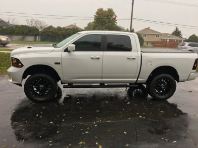

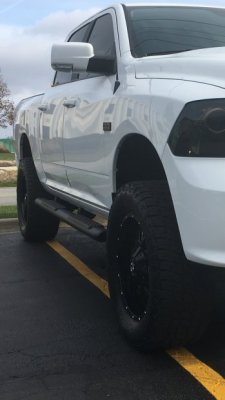

This is the 4" Zone with 35s the Bilsteins set at 1.4.

I have the 3" coils and the Zone shocks.
So what do you mean then the bilsteins are set at 1.4? Or do you mean just the adjusters are 1.4 with the 3 inch coils? So 4.4 inches of lift?

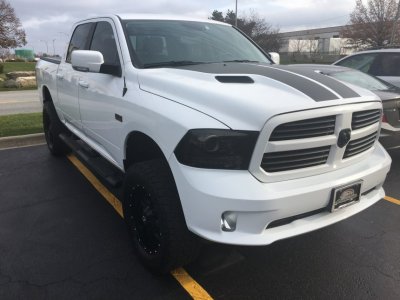

The Settings is at 1.4 I have 3 inch coils in the back not the spacers. People think it's a 6 inch lift. With this set up there's not much of a difference between the two
Oh okay I see what you mean. What kind of steps do you have? I wanted to put some on but have no clue what the best would be
Ferro
Sep 17, 2016
435
198
I have the Ram steps on now. I will be taking them off and going with The ICI magnumc.
