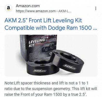

If you have the 1500 with independent suspension on the front , the spacer hight will be smaller than the actual lift obtained. Reason being is because the strut is closer to center towards the chassis of the control. So a 4" spacer will actually lift the front 5 or 6" at the wheel hub.
A solid front axle on the other hand like in a 3500, a longer spring or taller rubber spring bushing is inch for inch.
It is even advertised that way. Read note.
