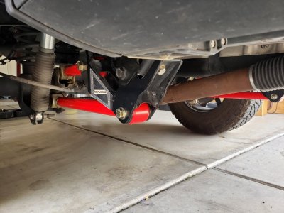

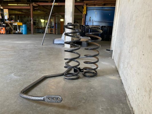

Change of plans, short term going 2” in the suspension and keeping the level up front for now. Going to wait and purchase everything needed and start sending parts out for powder coating. IMG_1249.jpg
