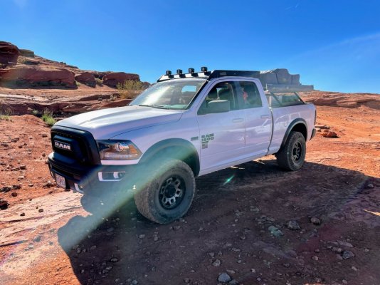

Are you capable of doing it yourself? If so, grab some bilstein 5100's set them at 2.8 in the front. add a 1" spacer for the rear and install a Zone 1.5" Body lift. That will net you 4.3" in the front, and 2.5 in the rear. This will be the same lift as the Ready lift kit, and will ride 100% better.
Here is mine with the aforementioned above on 35's
Another one in the dirt.
If you have to have a shop do it, Go with Zone or Superlift. 4" kits.

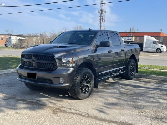

Not sure why anyone would say to steer clear of the ReadLift 4” SST kit, everyone has their company of preference or budget to stick to I suppose. I actually have the 4” SST kit installed from ReadyLift and have had zero issues, looks good, drives perfect, good lift height and looks almost level and yet the truck still fits in my standard height garage door.
Lifts 4” up front, and 2” in the rear so you end up with about a 1/2” rake when done (2.5” front lift makes the truck level, so it’s a level plus a 1.5” lift up front, then the 2” lift in the rear puts the back end 1/2” higher than the front, for a lifted/levelled look over all. Add in a set of 35 x 12.5 tires and you’ll get another 1” or so added to that overall lift.)
I can say from experience that the ReadyLift 4” SST kit was perfect for the lift and look I was going for and no complaints from me.

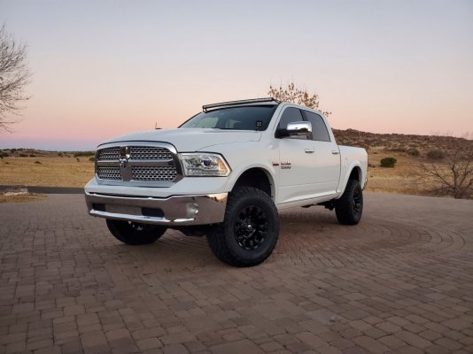

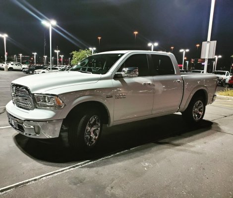

I too was looking to lift my truck 4 inches a couple years ago. Luckily, I was talked into going with a 6 inch instead. Everyone that I spoke to said I would absolutely regret it if I didn't. So I went with the Zone 6 inch lift kit with new Upper control arms, and I'm absolutely glad I did.... Before and after pics included.

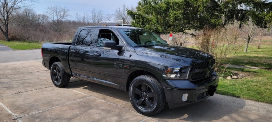

Here's mine with the Eibach Pro Kit before and a couple after.
