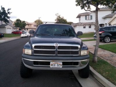

So here is a pic from the front showing the camber. Honestly the design of the upper control arms doesn't leave room for alignment better than it is.uploadfromtaptalk1394558119579.jpg

Thats bad very bad hope you are not driving it like that. Can you post up some pix of the up arms or just overall pix of the front suspension. Something tells me the crossmember under the motor had/has to modded to make this work right, can you tell if that has been modded?
Here is the link to the pdf install sheet you might check it over and make sure all the steps have been done right.
http://www.fabtechmotorsports.com/files/FT3200-6i.pdf

No legitimate lift properly installed will have an end result camber like that. I think Merc is right, there should be something bringing the lower control arms closer to the center line of the truck. At any rate you would probably be better off putting stock suspension back under this truck. I do not see any low cost way to get used parts to the islands. Your best bet may be contacting salvage yards in southern California and see if they would be willing to ship the parts. Good luck bro.

Merc it is bad (inside edge of tires is almost bald) and i am driving it very limited distances. i'll grab some more pics after work so you can see what i mean as far as no room to adjust the alignment.
no crossmember additions/modifications. checked the parts list, work order, and the instructions from kit the PO gave me and no mention of crossmember. PO had all the work done at 4 Wheel Parts locally. he said it was a 'prerunner' kit hence the camber, now i know 100% its a load of bull...

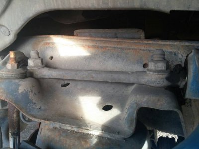

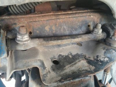

Fiiiiiinally got some usable pics! It looks like there might be some room to adjust the camber, hopefully take it into the shop this weekend and see what they say. Drivers side looks ok, passengers side is close...
