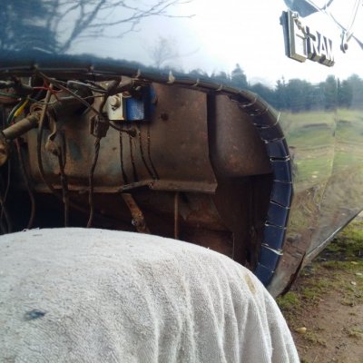

Here is the progress I have made so far in cutting and folding my driver side fender. Looks ugly right now, but will clean up once I fabricate my own inner fender. Will most likely be made of plastic or some sort of rubber compound. I had to relocate a fuse box, and also grapple most of the ignition wires to the side of the fenders since they can no longer sit on the inner fender (because I removed it). I will now be adding a cross support beam under the battery platform to strengthen it since it used to sit on the inner fender.

Does anyone have a suggestion for making custom inner fenders? Since my wheel well openings are about 1 and 1/2 inches bigger than stock, my stock inner fenders won't line up obviously. I just installed a rubber inner fender. I got a big sheet of rubber from home Depot and cut it so size, then bolted it onto the bottom lip of the wheel well. It looks alright, but since it's not rigid, it has bends and folds in it creating a messy look as you can see in the picture. I am going to start over the inner fender, what do you guys suggest for making a more rigid set up that will look good? (preferably does not require welding)
I have it just zip tied right now since it's not the final product.

Only thing I can think of would be to try and get some fender liners out of a newer truck and mount em in there some how.
crazzywolfie
Apr 6, 2013
16,646
3,430
under the truck
81 93
5.2
or just modify the stock inner fenders to fit just like you modified the fenders to clear tires.
dzltek
Jul 30, 2016
106
81
3.6
What he said. If the fenders are an inch to inch and half larger now, why not just cut and stretch those old inners. But if you want something custom, cut some old 55gallon drums and use them.
