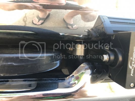

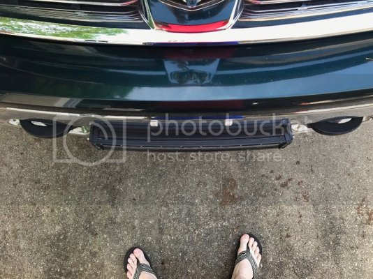

So I have been wanting a light bar for a long time but did not want to sacrifice my tow hooks and I didn't want one on the roof. So I did some looking around and found a 22inch curved light bar with both flood and spot lights in it.
So I took the plastic trim piece out between my tow hooks to open the gap up a little more and fabricated some brackets out of flat aluminum bar I got form lowes and used some preexisting holes in the frame. I think it turned out pretty nice. I doesn't recess in the bumper like the 2500's but it works.

Thanks, It wasn't to hard once I figured what to use. I bent the metal by hand, then just drilled the holes.

Any chance you can post some pics from further away? One from the side that shows how much it sticks out? Thnx

I'm going to remount the license plate holder too. Just have to measure it and drill new holes. I'll Post pics of that to once I get it.
I can do that.

Looks good! Like Rzrman said, think you're the first to mount a bar there on the big horn models. Lots of guys have ask3d about it. I was just gonna stick a single row bar in that spot.

I think so too, tried finding other ones as an example. All I could find was 2500's, sport bumpers, or people removed their tow hooks to do it. So hopefully this will help someone wanting to do the same thing.
