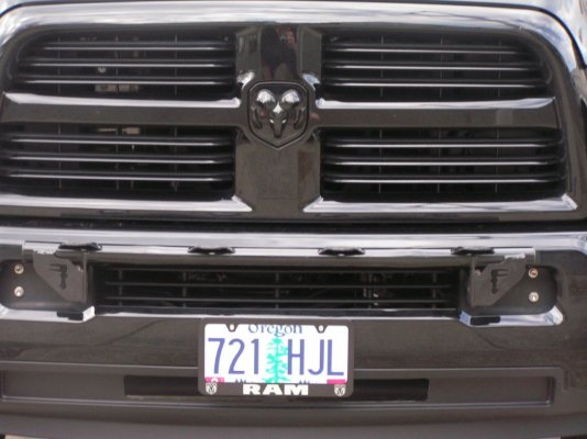

Check out NFAB for their lightbars (they mount behind the tow hooks if you have them) or consider a 20 - 30 inch light bar in the lower part of the grill.
Here's my 2007 & 2014 with the NFAB light bar:
The 2014 with the same setup:
I decided to go with a PIAA lightbar on the 2017:

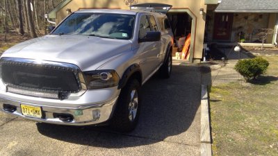

2020 Power Wagon
Thanks in advance for any responses. I have a 2017 1500 Laramie and I really would like some extra light. Recently drove from Salt Lake City to NorCal at night in heavy snow and some more ground light would have been great. I’d like to mount a bull bar and attach a light bar to that but I’m worried it’ll mess with the parking sensors. Does anyone know any other method of mounting a light bar close to the bumper? Once again thanks. ac4da34eac346a6b5a5cf6c7b42d03f7.jpg
I attached mine to the top of the front bumper. I used a Dremel to cut through the plastic bumper cover and then installed Rivnuts into the metal bumper. I have a 20 inch bar mounted for close to 2 years with no issuesWIN_20190316_11_30_57_Pro.jpg

I attached mine to the top of the front bumper. I used a Dremel to cut through the plastic bumper cover and then installed Rivnuts into the metal bumper. I have a 20 inch bar mounted for close to 2 years with no issuesView attachment 159444
I’m thinking this will be the route I go. Thanks for all the responses.
