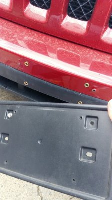

On my Ram I installed an aftermarket bumper, but on my little Jeep I used a license plate bracket reinforced with some rivnuts directly into the plastic bumper cover; I don't know if that idea helps you at all but it's been a rock solid answer to the mounting situation on that vehicle.
