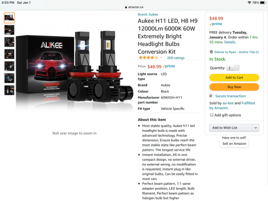

I’ve been using these. Bought them for $30 on sale. Low beam only. They’ve been in the truck for over a year now, no issues. They are definitely brighter and better than the stock bulbs.
Second benefit: They put off little heat so road dirt/spray doesn’t bake or freeze to the headlights. They stay reasonably clean in winter.
I tried a pair of Sealight led’s before but everybody and their dog was flashing as I drove past them.

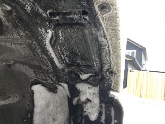

The existing low beams are H11. Plug and play. Passenger side under the air box was not fun.

just looked up the Aukee bulbs. theres an 18000 LM version. any thoughts on that? I guess would be the equivalent to 50 % brighter than the 12,000 LM version.
you think would this be too bright and blind on coming traffic? I drive alot of back roads and have to keep toggling on and off when using the LED off road light on my truck for on coming cars.
the 18000LM does come up as "fits 2015 RAM 2500" unlike the 12000LM version
Are you saying you installed the bulbs without pulling the headlights out? That's a lot of extra grief for nothing. Two bolts with an extension and clip and the headlight buckets pop out.
On mine, there’s a flap in the wheel well to access the headlight… drivers side was easy, passenger side required many 4 letter words as there‘s little room and the headlight cord is short.

The 18000LM version might be too bright, maybe. If you buy them and everybody you drive past is flashing you…. Amazon usually has a pretty good return policy.

The first pair of LED lights I bought for this truck were Sealight brand. They were in the truck for 4 days. Everyone and their dog was flashing their light at me, obviously, this was a problem. I bought these Aukee ones on various posts I had read here and there that said the filaments on stock bulbs matched up perfectly with the led chips. Nobody flashes their lights at me anymore. Is it the best solution, no. Do I want to spent $500 on lights, no. Same as I didn’t want to spend another $10000 to get an over optioned Laramie (that has led lights).
