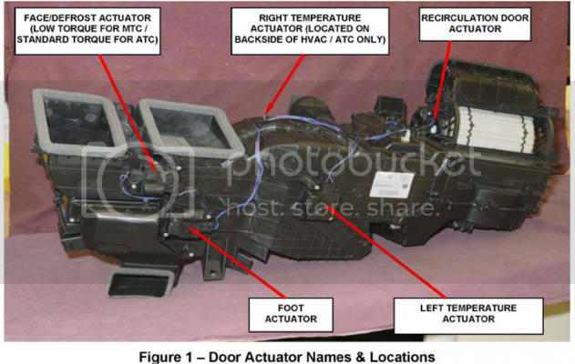

Generally when you only get air to the floor the "Foot Actuator" is bad and needs to be replaced. Right under the radio with the bezel removed.

The foot actuator only distributes air in to certain areas. It should have nothing to do with the panel lights correct?
It pretty much determines whether you have defrost air to the windshield or heat to the floor. If it is bad you will only have heat to the floor, no defrost.
Nothing to do with the panel lights. It is possible the switch panel could be bad and causing your problems as mentioned above, lights and actuator problem.
