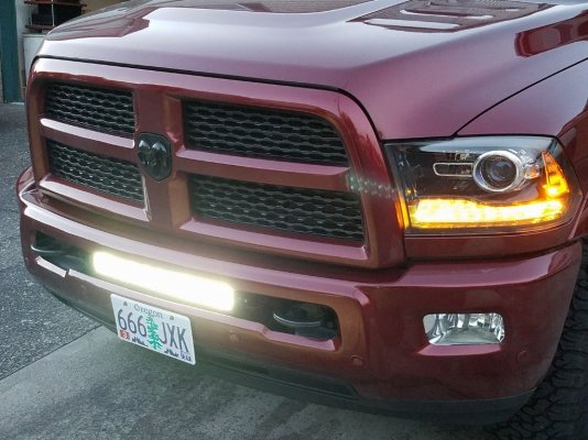

I kept my tow hooks and put in a 20" LED lightbar in between them with no problem. It's a kit from PIAA. The brackets bolt in behind the tow hooks and allow me to keep them on the truck.
You can fit a 30" bar there but it will require you come up with custom brackets.

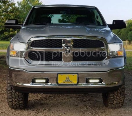

/\ /\. What Ramm5.7 said!! I followed his example, as it was an excellent OEM look. Before LEDupgrade to fogs and headlights btw..f2e4bb9b676f7d305df8699357d0f5c2.jpg

Those are nice Ramm5.7 . Do they throw a lot of light ahead of the truck at night or are they just glorified fog lights?

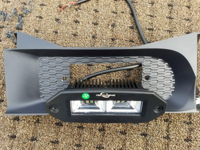

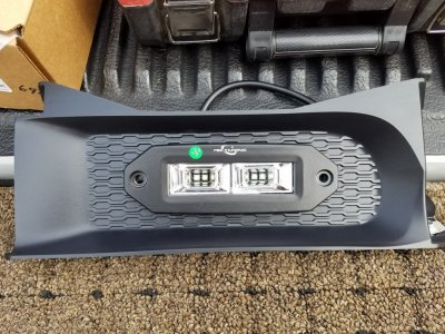

Well thats a subjective question. I started with mictuning 18watt floods and wasnt happy. Too much side(flood) light so swapped to 40watt. Very bright , much better long range. I couldnt find spots that are flush mount that size to fit tow hook covers without major work to make fit. I then added the 7 inch spot pods behind the grill and they are awsome! I did all this while still using oem halogen headlights and fogs. Since swapping to Vanquish Auto (a vendor here) led fogs and low beams I only use my added lights on really dark roads when driving alone.

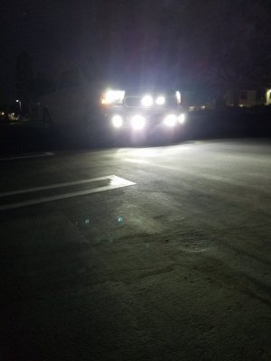

These are the only comparison pics I could find
C
cityboy21
Jun 3, 2018
97
64
NW Indiana
Wow. Big difference in that last pic. Is that with just the tow hook lights or the LEDs in the low beam and fogs too?

That was oem halogen headlights and tow hook only, way before i installed anything else

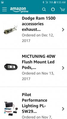

Ordered all off amazon

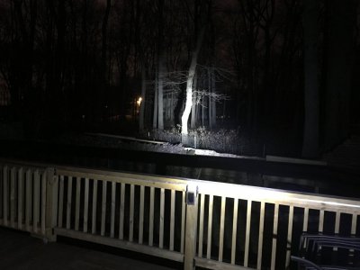

I did the best and brightest you can fit in the tow hook areas. Rigid SRAs same install as the other guys but I went with a spot beam and they are wicked bright. They have more lumens and distance than diode dynamics and any eBay brand. But they will run you $200 ish. Pic on the deck was just 1 light and trees are over 100ft away. Other pic is with just the rigids on.

1. Just google PIAA LED lightbar. You'll find the light, harness and switch easily enough.
2. I didn't take any pics when installing. I had my hands full of tools. But it's not hard. Unbolt the tow hooks, pull them out, put the bracket on the back of the tow hook with the light mounting tab facing inwards towards the center of the truck, slip two bolts back in (one per side of the tow hook), holding on to the tow hook and bracket slide it back into place, then put the nuts on and thread them loosely. Put in the rest of the bolts. The bracket and tow hook will level up as you tighten the nuts. Repeat for the other side.
A second set of hands comes in handy for being able to remove and reinstall the bolts as it's hard to be on both sides of the lower radiator core support at the same time.
