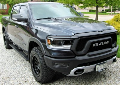

Rebel > LED reflectors/black housing
Halogen standard on Bighorn/Tradesman
LED projectors Longhorn/Limited
Lil incorrect. Would depend upon when your 2019 was made. I have a early 2019 Bighorn and I have mid range LED's all the way except for CHMSL, they are in reflector lenses, they just do not turn and adjust like on the high end limited models, but the corresponding fog light comes on when U turn wheel if fogs are not on. Now my son just bought a 2019 Bighorn a few weeks ago and he said the dealer told him on recently built Bighorns, only quad halogen available. TRUCKIT: As far as 4 headlights forward, when on low, that has got to be something with Canadian requirements or different transportation laws, ., but alas, so not saying U did, but a lot of people use AlphaOBD and such and modify their trucks and change a lot of stuff. Depending upon the state in US U R in, a lot of PPL play and add their "fog/running" lights when other 4 is on and in TX that is illegal. Just saying, all IMHO.....

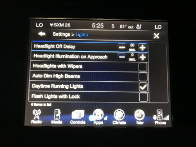

You have the auto high beam turned on, the sensor is behind your rear view mirror and headlight switch is probably in AUTO too. If you want to disable it simply go to your screen and select the following:
  • Controls
  • Settings
  • Lights
  • Un-check auto dim high beams
Try it and reply back and let us know if that worked.

How ‘bout instead of turning it off completely, can’t you treat these new trucks like the later 4th-gens and just pull back on the dimmer switch to turn them off?
