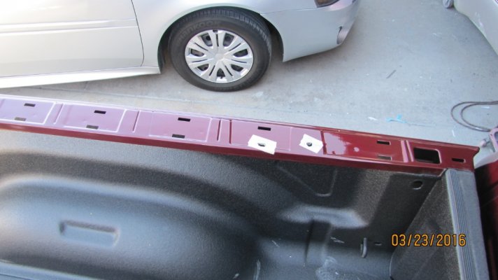

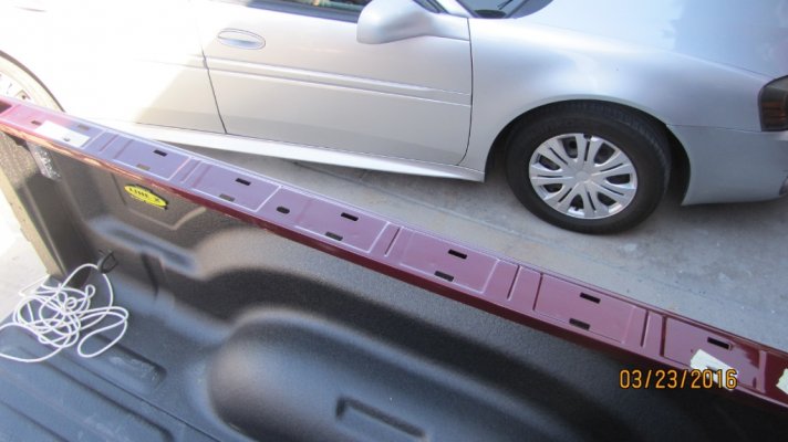

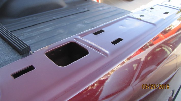

I have had 3 pickups sprayed with Line-X
1999 Chey 1500
2009 Dodge Ram 1500
2016 Ram 1500
They remove the tailgate to spray the bed
They remove the tailgate inspection cover
They pulled or covered anything that you do not want sprayed
I would have liked that they could have sprayed over the rails, but that would take a lot of extra body work

This look professionally done sir. I only hope these local guys do this good of a job. Not to mention they want $799+tx for it and I have a brand new truck.

Spray the rails with some Raptor bed liner , you can get it in a can ready to go ... just scuff the plastic, use some adhesive promoter and spray the raptor bedliner ... I am going to be spraying mine pretty soon ...
