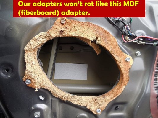

Lol... the rotting looks like the car was underwater. If that much water gets in your door - you have way bigger issues. But yet, pvc is a great way to go, I use it for baffles on my boat.

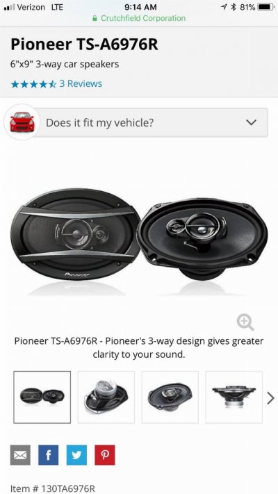

I’ve got these Pioneers in all four corners and they fit fine no spacer required for me. https://www.crutchfield.com/S-501a7SLuwpN/p_130TA6976R/Pioneer-TS-A6976R.html710014f0ccc3938dab5d0ad3ebef5b6b.jpg
2016 5.7L Ram 1500 QC

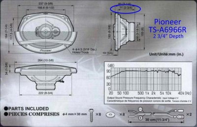

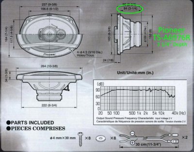

I've been researching 6X9 speakers that will fit in the front doors of my 2018 Big Horn. Could you verify that it is indeed the Pioneer TS-A6976R (seventy-six R) that fits in your Ram 1500 and it's not the TS-A6966R (sixty-six R)?
I ask because according to the Pioneer owner's manual, here are the speaker depths:
TS-A6966R 2 3/4"
TS-A6976R 3 1/4"
I've seen a couple of posts where the available speaker depth is 2 1/2" or 2 3/4" but never over 3". Although, here's one that shows it being 3".
http://www.ramforumz.com/showpost.php?p=1634570&postcount=2
Therefore, I think I should buy the TS-A6966R speakers.
