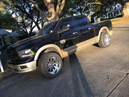

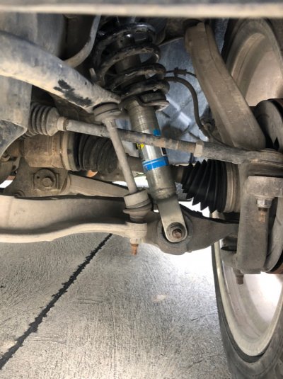

I’ve got a 2” spacer on tops of mine set to 2.8. The cv angles aren’t too bad in my opinion, the thing I’d mostly be worried about is the angle of the upper ball joint. It’s pretty steep, but I’ve had mine like this for over 6 months with no popping or breaking. Everything I read said not to do it, so that’s something to take into consideration as well. b71712f4756187044ece2fe6f99b0620.jpgcdfa8fa89983593ec07b13e69fa4b33a.jpg

That actually looks really good! Could you possibly take a pic of the upper control arm ball joint? And also what brand/kind of spacer is it that you have?

That’s the angle that’s going to be the problem, if any. Also, just did a quick measurement and the front is 1” higher than the rear like this. I don’t know the brand of the spacer, probably just some generic eBay one. It was on the truck when I was installing the bilsteins. Figured just to leave it there and get some extra lift.
