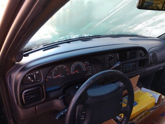

Bit the bullet and ordered the pad and bezel last night. Merry Christmas to me!

Installed it last night (without completely removing the dash :grin:) it looks great overall. Yes I got all the screws behind it, and yes it was a royal pain, but worth it to me because I don't think the rest of the dash would have survived a complete removal.
Unfortunately the plastic "skeleton" of the dash has not completely survived the years and has cracks and broken chunks out of it. A few spots holding in the accessories are compromised. I'll be bolstering those sections with epoxy or Super-glue to bring it back to usefulness.

She looks practically new (at least in the inside), now!6904bdf25dbe54cb6a65a77488b74adf.jpg
