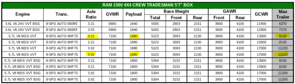

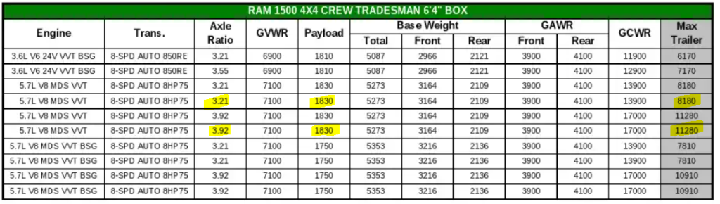

They're not elusive.... You just have to know how to read them.
Google search your year model Ram towing charts and it will pull up the Stellantis Tow charts. They don't offer 3.23 gears. Your options are 3.21 or 3.92.
Fair warning, this is a BASE number and most of what you find will be for a tradesman or possibly a Big Horn. The actual towing capacity is based on the trim level of your truck as well. For example, a Laramie or Limited will have significantly less payload or towing capacity than a tradesman because of the additional features. The door sticker is the final answer for that specific truck.
But, as an example:
2023 Ram 1500 Crew Cab Tradesman with a 5'7" bed:
2023 Ram 1500 Crew Cab Tradesman with a 6'4" bed:
Important to mention is that max trailer weights and payload capacities often contradict each other. You'll often run out of payload long before you reach max trailer ratings. If you have a flatbed trailer where you can shift some of the weight towards the rear to lighten the tongue weight you can get closer to max trailer ratings. If you're towing a travel trailer or a trailer with fixed weights that can't be moved you'll almost always max out payload first once you've added the weight of passengers, any add on accessories, and cargo.
