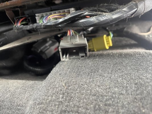

i have this plug under the seat but nothing to plug into it

hmmm - what year are the seats out of? I know 2013 and up are different and not sure they'll work plug and play.
Yeah, you may not have all the wiring in place. Some trim levels didn't have all the wiring from the factory.
This site will show you the connectors and wiring pinouts, I'd start there.
This thread is for 2013+ trucks but does have some very good info in it.

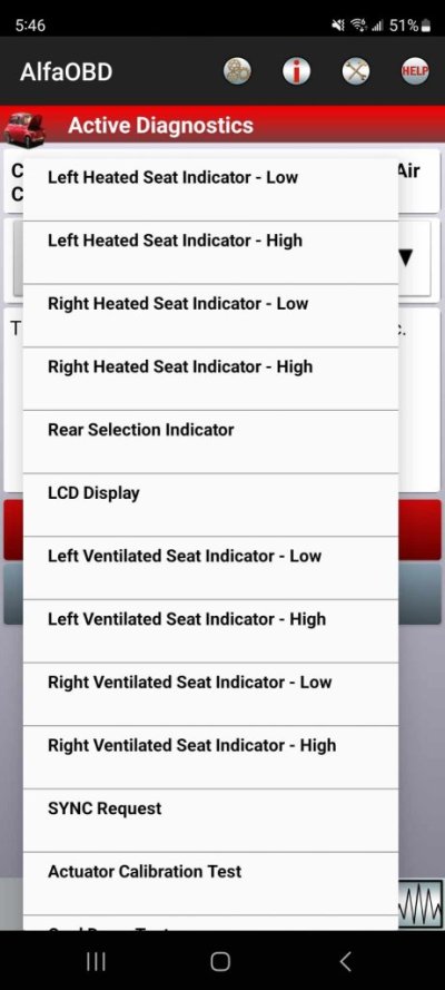

so snooping around in alpha i found these settings..should i have these turned on by chance?

I think those are just testing for the lights, not 100% positive, but I know I didn't need to touch those on mine
Those are for the indicators on the buttons. There's a "hi" setting and a "low" setting to indicate how much heat/ventilation you want applied to the seats. This applies to 4th Gen and older.

@Black-Wolf yes i have a 2012 and no indicator lights come on when i press the button so should i enable these
Yes, you should or you won't have any feedback as to whether the heated seats are on. Are they ventilated too? If so, enable the lights for those too.
