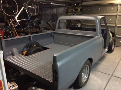

OR, you CAN shorten factory stuff. Truck would be down longer, but its 100% do-able. If you are a competent (truly, honestly competent) welder, you're ahead if the game. If you had to pay for all of the welding, it's a money losing proposition! I've done three trucks. A '59 Chevy, a '66 Chevy and a '68 GMC. it's not horrible. Body work is the majority of the actual work. Heres my '68 GMC (wrong brand, I know) part way through the process. This truck got shortened on both ends of the bed, as well as tubbed 4" per side, to make room for drag slicks for. You can see the "scars" where the tbed was shortened. I can show how I shortened the frame, but will have to take some photos. This type if work is fairly universal across brands. Step sides are easier than fleet's! Fleetsides get a lot more labor intensive!IMG_1783.JPG IMG_2006.JPG IMG_1794.JPG

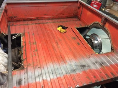

if you do go the cut and weld route, I'd expect you'll be doing a lot of hammer and dolly with a mig welder on body panels. Even with the thick sheet metal of the older trucks, the heat with gas mix mig is still going to give you a bunch of warping. Problem is most of the bed body is double wall so hammer/dolly may not be easy to do. a few of the more warped areas I couldn't reach I actually ended up using my stud weld dent puller, over correct and slowly just hammer it flat as possible. I'm not saying its not doable but add more time/labor to get the sheet metal done. After my Tig broke down, I've been using my Mig. I did do my current truck body with the mig, just had to use way more filler than I'm usually wanting to use.
