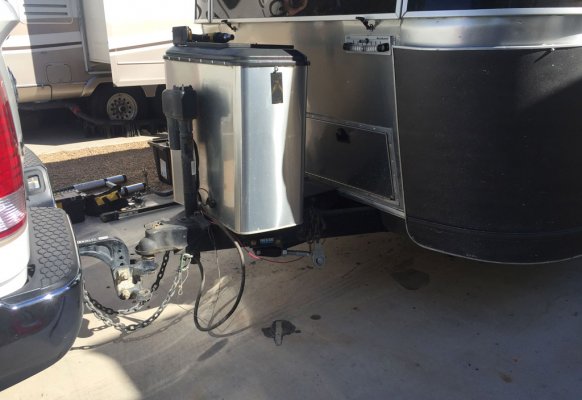

Turn your jack side ways. Like so. It turns. Just don't turn it with the trailer weight on the jack.

^That works fine if you have a power tongue jack. If you have a manual jack with a handle which needs to clear the propane cover, you're S.O.L like the rest of us. The tailgate not lowering was the contributing factor to my dropping one of my 6V batteries while lifting out of the bed of the truck last summer :(
