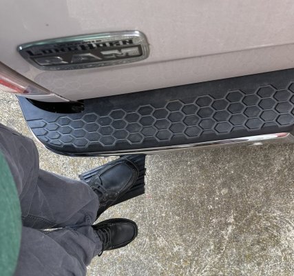

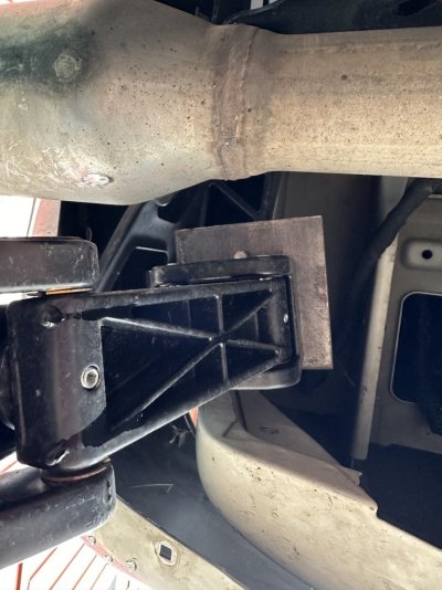

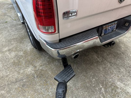

If you are handy and are willing to have an imperfect setup… I just did this a couple weeks ago. If I were better with CAD I’d design a new step but in the meantime this is what it looks like.
I bought a 4”x4” 3/8” thick piece of steel and drilled/tapped/counter-sunk one hole, drilled 2 bigger holes basically pushing the step 1” further from the exhaust pipe and rotating it 15°. Then I cut off the edge of the oversized step parallel to the exhaust tip and glued on a piece of ABS scrap I had.
Looks a little hokey but works perfectly for what I need.
I got the idea from a guy I ran into at the grocery store. He skipped the metal extension, cut off a bit more step, and put up with it hitting the exhaust pipe. Worked perfectly for what he needed.
Old knees suck.
