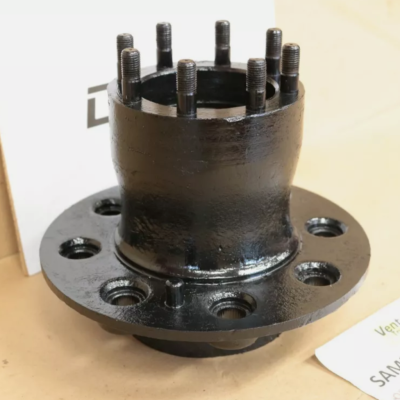

It's a full-floater either way. What i mean is the shape/profile of the protruding hub. It is shaped like a vase, you can't convert to use a hub-pilot wheel. If it's shaped like a tin can (a true cylinder) then maybe you could use 94+ dodge dually wheels.
Edit: 0.5" wheel sizes were the first mainstream attempt at tubeless tires. 19.5, 22.5, and 24.5 are still common. 14.5 and 17.5 have held on for trailer use.
Edit2: vase/bell shaped hub that can't hub-pilot the outer dually wheel:
